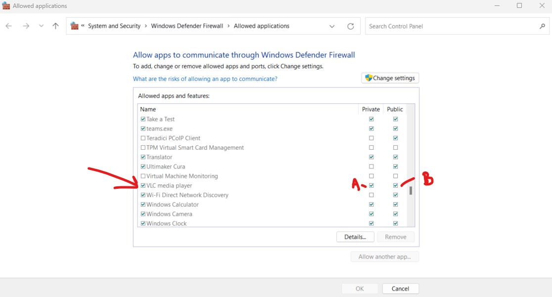

I don’t have much experience with adjusting the firewall. I took a screen shot here with what it looks like atm. Anything you think needs changing?

The firewall settings look ok, basically VLC is allowed to play network locations, think it will apply that rule automatically on install so it’s a bit weird it has issues but you’re not alone on that one. Maybe it has to do with the fact that because it’s a network location VLC expects a ‘stream’ which most of the time is a different format or mp4 with different settings optimized for streams. I wouldn’t personally care too much if VLC can play it or not if other players play it just fine.

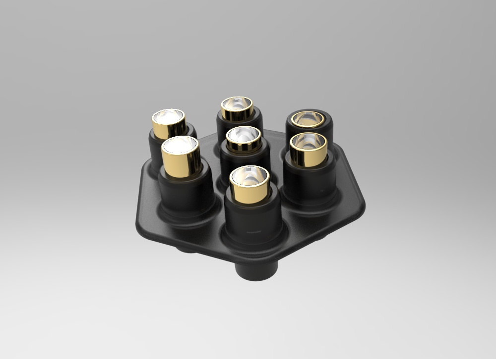

That still is btw 1000x725 pixels so if you would create a timeline/project you could just make it the same size and same fps as your Keyshot animation timeline.
